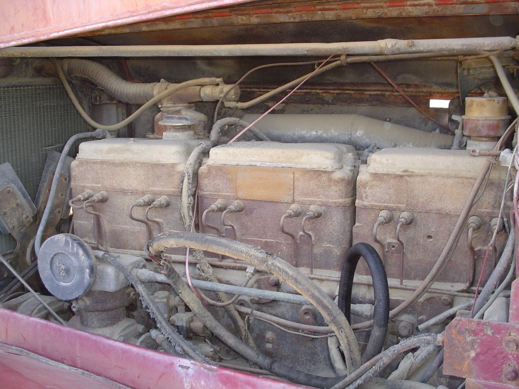

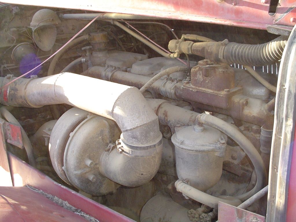

left side
right side
lot of hotroddin goin on back then!!!
Neat photos Ron, turbo on an old H or HR series motor. There were never any Cummins factory turbocharged H/HR 2 valve motors, were there?, only Roots blowers on HBS600 and HRBS600 motors I think. Has this motor been refitted with a PT pump?

Aaron (07/02/2013)
A 180 and a turbo I don't believe are a match, it can and was done but I don't thinks its a Cummins setup, that motor could be rebuilt into anything in the small bore series, so a change of liner,pistons,injectors,and timing could make it a NRT 300 or even a NRTO 335, you really have no way of knowing what it is, it may very well be a 180 with a turbo, or it could have been kitted to a 262.
A very latge turbo could be one of the T 590's but without a picture it might be something else.
left side
right side
